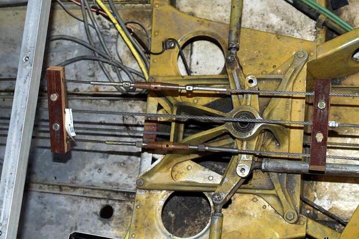

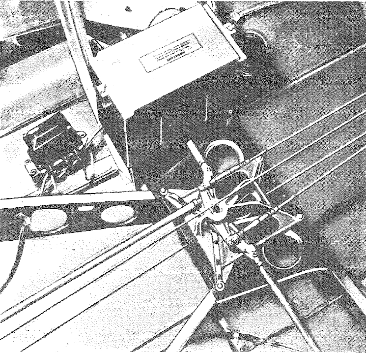

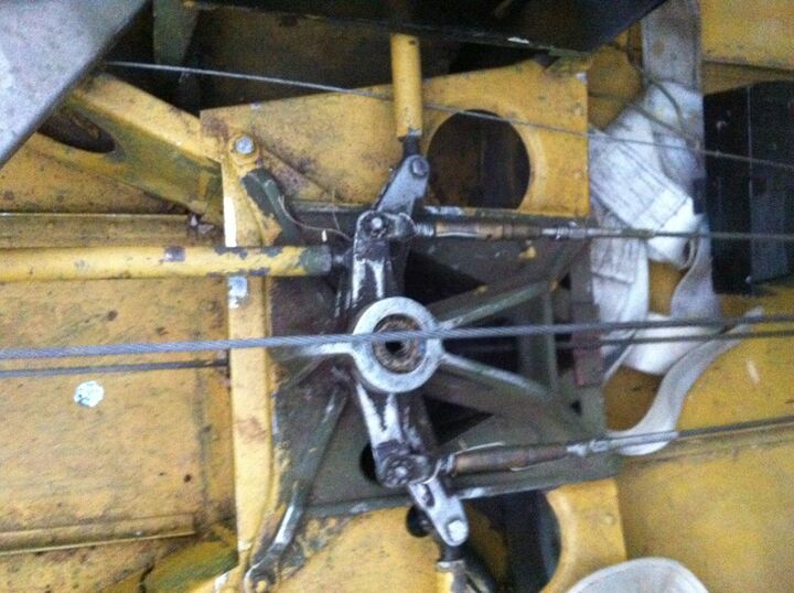

Thanks Matt & Ron! I found SB59 no drawings though. From your description in your reply and the photos I found it looks like a very straight forward job. Remove extensions, remount the clevis to the original cables still there, and boom. Done. I'm a bit of a visual learner. Takes me a moment to understand.

When I removed my pedals, the original rudder cable was still there, and extended to the rudder pedals with a turnbuckle connection. I just unscrewed the extension cable, screwed a clevis into the turn buckle, and attached it to the "mixer". The rudder cables cross inside the fuselage so that when you bank to the right, the rudder also turns to the right so the turn is coordinated. I spent a lot more time checking rigging and adjusting cable tension than I did actually removing the rudder pedal assembly.
