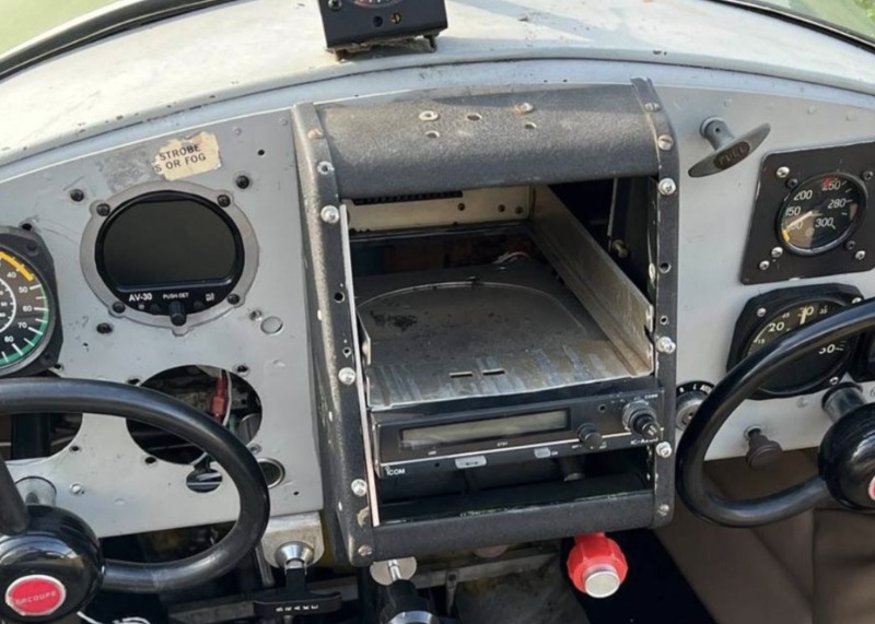

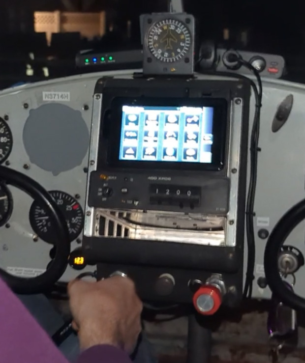

Om betting that Larry is correct about you having a Stromberg carburetor. My coupe was changed to a Marvel-Schebler carburetor in the past, so it does respond to "Idle Cutoff" in the way you'd expect in a Cessna, Piper, etc. There's no problem with a properly-operating Stromberg carburetor, but if you ever decide to make the change it's pretty straightforward.
Concerning installing a GNS430w, there's very little depth behind the instrument panel because the center fuel tank is located there. There's only 6-7 inches of depth available behind much of the panel! The Ercoupe wasn't even designed to fit the depth of a COMM radio in the panel. But that does mean that workarounds have been found.
My Ercoupe had a radio added in the 1970's - a big honkin' vacuum-tube unit that would never have fit, and would've been kind of absurd hanging below the panel. The solution was a big "bump out" fascia that was added to the center of the panel. They cut out a big rectangle in the center of the panel and then screwed this avionics rack unit to cover the hole. The throttle, Carb Heat,& Mixture knobs also fit into the bottom of this unit.
I ended up removed mine & installing a compact remote radio & matching transponder, but the "bump out" always worked fine... I just needed to upgrade my avionics and that was a chance to get rid of it. Here are some photos from before the removal:
